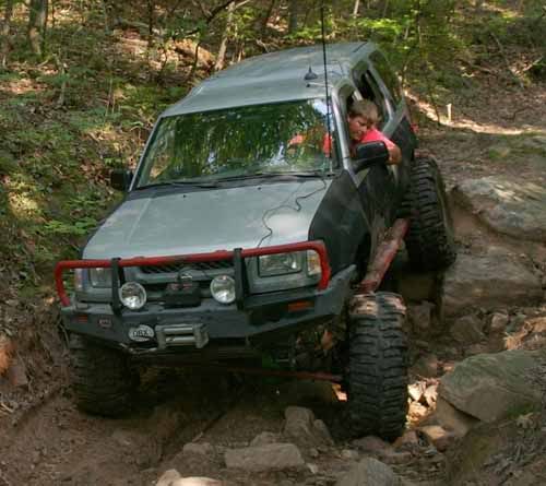

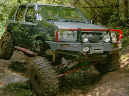

Got this X the other day. Took it out today.
got some work to do on her. I'm seriously concidering the Calmini tcase gears, I wasn't happy with the crawl capability. (I'm used to 4:1 in my jeep) Also gotta get a new front drive shaft. That one is way to short and slips apart when i flex it out good.
She has a SAS with Locked D60 front and Locked Sterling 10.25 rear, 5:13 gears in both.. Looking forward to wheeling the X more. Its got a unique look on the trail than a jeep thats for sure.
