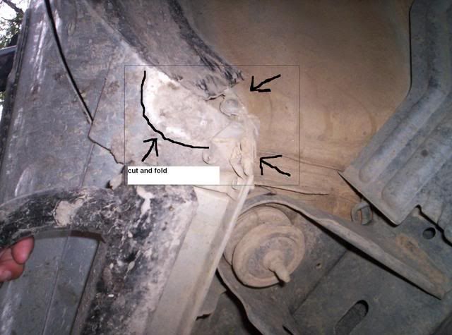

my xterra isnt black, but, i have similar steelies, they are 15x8, and 3.75 bs. i have a pml and 32x11.5r15 goodyear mt/r's. i had to take the plastic part that the front mudflaps attached to off completely, plus i cut and folded some sheet metal up there... all that just for the wheel to turn all the way in either direction with no compression. im sure i can put the plastic back on with major cutting of the plastic. in the back i had to put 1 1/2 inch bump stop extentions to keep the tire from tearing up the body on compression...minor compression.i will post pics in a few min. i have to upload them.

the X is dirty so pics arent the best but you get the idea.

So is it because of the backspacing that you needed to do all the trimming, if I have something more like 4.25 then will I be fine? I too am not a fan of body lifts, so I'd like to avoid it if possible

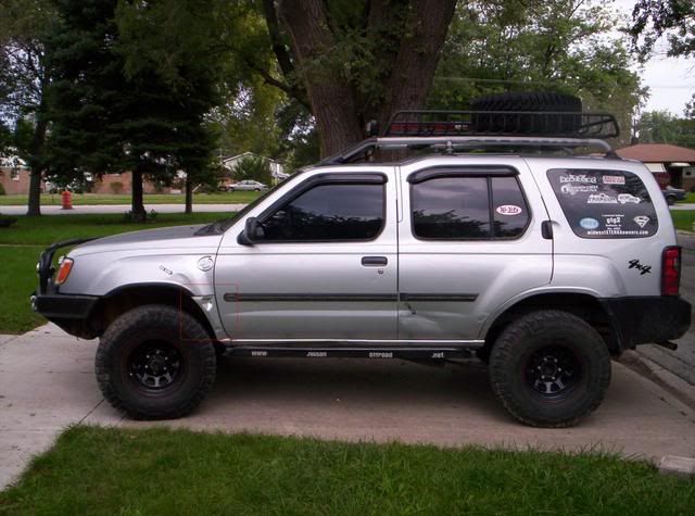

These are 15x8 3.75" BS Rock Crawler rims I'm running a PML and a 2"BL and those are 33s under there, btw, with a bit of trimming up front and no trimming or other modifications in the rear.

your x looks great too... Thanks
