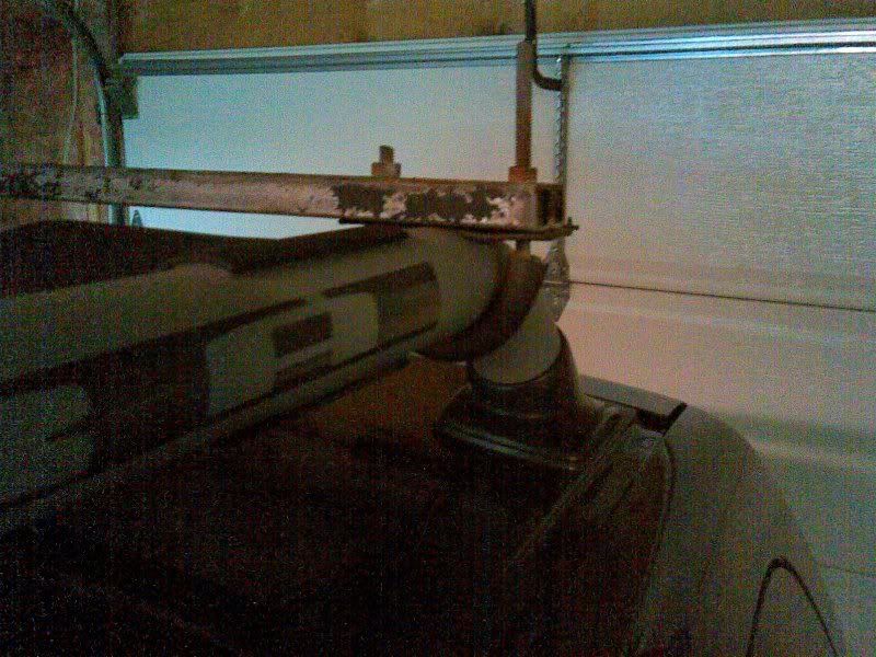

I don't know what size it is and mine is not here either. But I used muffler clamps for my home made cross bars. I bought the clamp slightly larger and covered the u-bold with black garden hose to protect the tube from scratches and prevent slippage.
Looks like this. Sorry for the bad quality. Camera phone and bad lighting.

I just went in the garage to check, the Xterra is not there, but I found one of the left over top piece of the clamp. They are made to fit over a 2" muffler and as you can see in the picture, with the rubber hose on top it's a perfect fit.
There is 2"1/16 between the two holes, 2"1/2 center to center.
#31874 - 25/06/07 12:10 PM Re: Rack tubing size?
Thanks! That would make it a 2" muffler clamp. The picture didn't post, but I got what you were describing. My thought is to use 2" aluminum angle for the crossbar and use the muffler clamps to clamp it to the rack frame. There's a connection I'm working on to connect the clamp to the crossbar. I got the idea from TrailMix from an old post.
