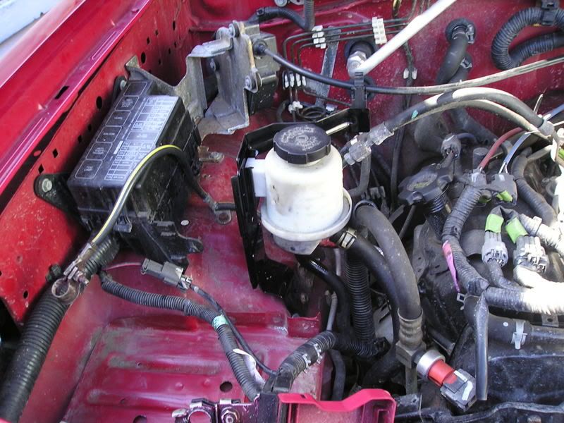

Most of the extensions seem to be on an as-needed and per vehicle basis, some people need them, some don't. I didn't have to extend my power steering line (just relocated the resivour), didn't have the extend the fuel filler or e-brake cable either.

Modified Power Steering res. bracket:
