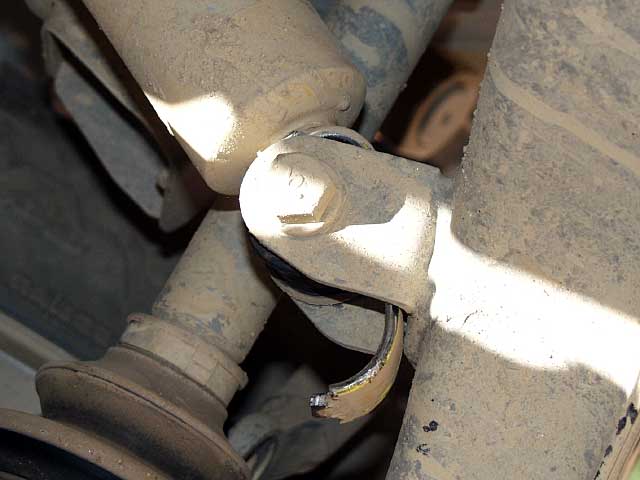

I broke another Bilstein front shock over the weekend, that's my second so I decided to do some investigation.
The shock is failing under compression. The shock is simply too long and it splits the bottom eye mount when compressed.
The stock shock on the Xterra is 8.625" when compressed and 12.4375" extended.
The Bilstein B46-1099-H2 is 9.375 collapsed and 13.25 extended.
I will be contacting Bilstein this week to see if they can explain why this shock is being sold as a replacement for the Xterra when it is 0.75" too long.
Here is a picture of the one I broke last September (driver side), it broke in the same place as the one I broke today (passenger side).
Time to switch brands again, maybe someone can make a shock that actually fits.
NISMO lists a Rancho that is 13.25" extended and 8.69" compressed, but I can't find a match in Rancho's catalog.
The other option is to finally cut the shock tower, have a loop fabricated, and move to a longer shock.

OK, I'm only looking at a picture, but the breaks look like the are caused by over exstension, not over compression. Am I missing something?

Loc: Redmond,WA
That's what I thought at first too, but the Bilstein is plenty long enough to handle the suspension at full droop.
It looks like it was peeled open from extension, but it is happening under compression, since the force on the shock is not vertical, but at an angle.
Side force is put on the eye at that angle, and it splits open at the weld. It then opens itself up as the shock extends itself over time. It takes a while for the eye to fully open up like in the picture.
Another thought is maybe I had 2 defective shocks. The 2 broken shocks were a pair last year.

Would this only be a problem on lifted X's? Since my minivan isn't lifted, would I have this problem on mine if I were to buy the Bilstein's? Or should I just go with Rancho's or something?
This is how you post whore..
#420130 - 19/05/02 11:50 PM Re: Broke another Bilstein
ChuckH Offline
Registered: 27/02/01
Posts: 5206
Loc: Seattle, WA
Originally posted by SCoach:
Whoa! Interesting thread!
XOC. As I see it, you've got 3 choices. Either some 1" longer bumpstops, or lift your truck 1" or install some springs that won't allow the truck to bottom. This last choice is what most people do, the first choice is what most knowledgeable people do.
ChuckH - The Rancho is not even close in build quality to a Bilstein. I wouldn't install one on my truck. Put them both in your hand and look. It's no comparison.
-P
I have the Bilstiens and the Rancho RSX shocks. The Rancho's seem to me to have beefier mounting eyes and a much heavier valve rod. I think the Bilstiens are far superior in every other way though. Maybe the other Ranchos are not built as heavy as the RSX? All I know for sure is that the Bilstiens give me a phenominal ride and control that I don't think any other shock can come close to.
"Every morning when I wake up I know it's not going to get any better 'til I go back to sleep again!" Al Bundy
